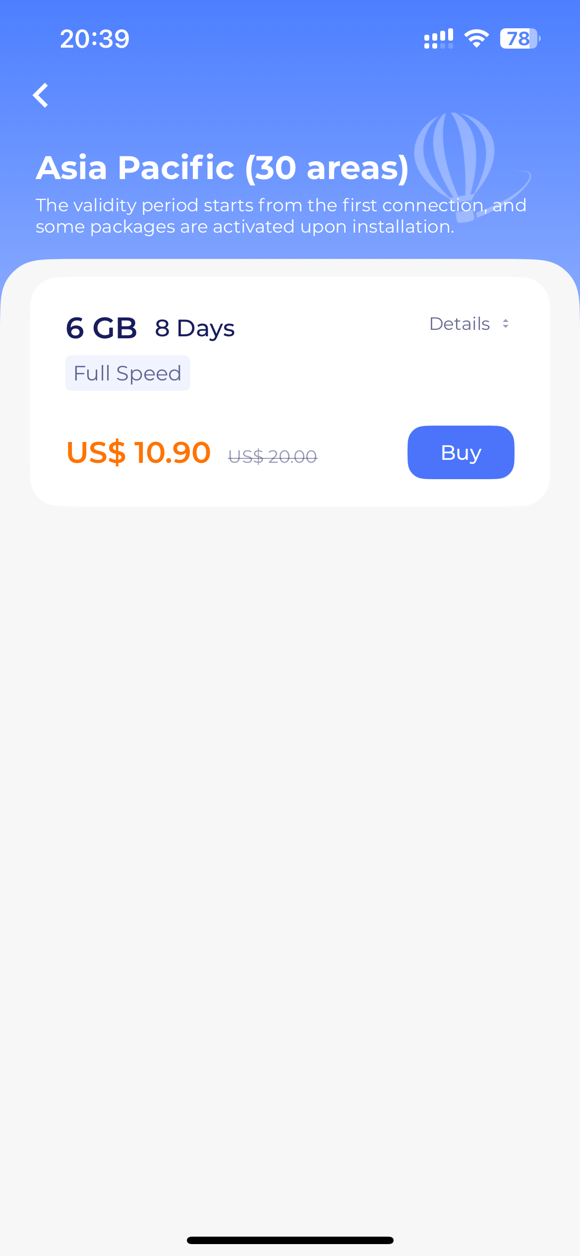

你需要花多少时间和金钱?(How much does it charge)?
- 开卡:10.9USD
Purchase: 10.9USD
- 购卡后余额:0
Initial balance:0
- 购卡后套餐:8日6GB 5Day 亚洲漫游套餐
Initial package :6GB 8Day AISA Roaming Data

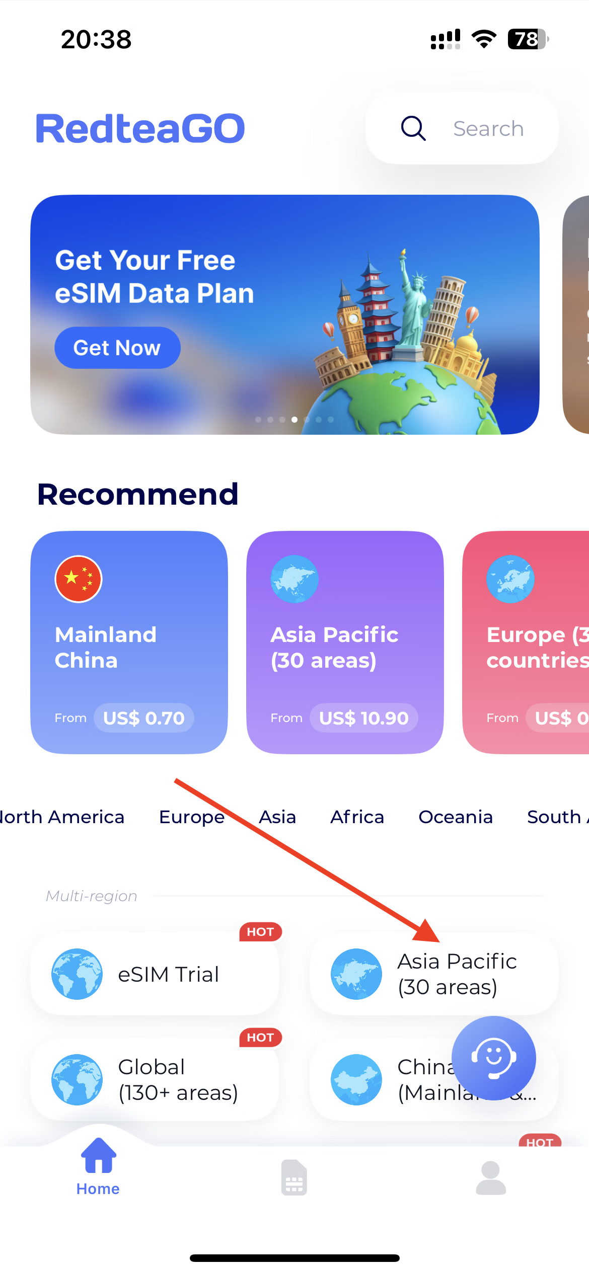

名称(name):在RedteaGo中进行购买,如果你没有欢迎点击注册:👉🏻 [RedteaGo],   或使用优惠码 ‘[DIVE0009]注册帮你减少3USD购卡成本
Open RedteaGo APP to get it, Click to apply If you do not have an account : 👉🏻 [RedteaGo]  or Copy refer code help you gain 3USD credit: ‘[DIVE0009]

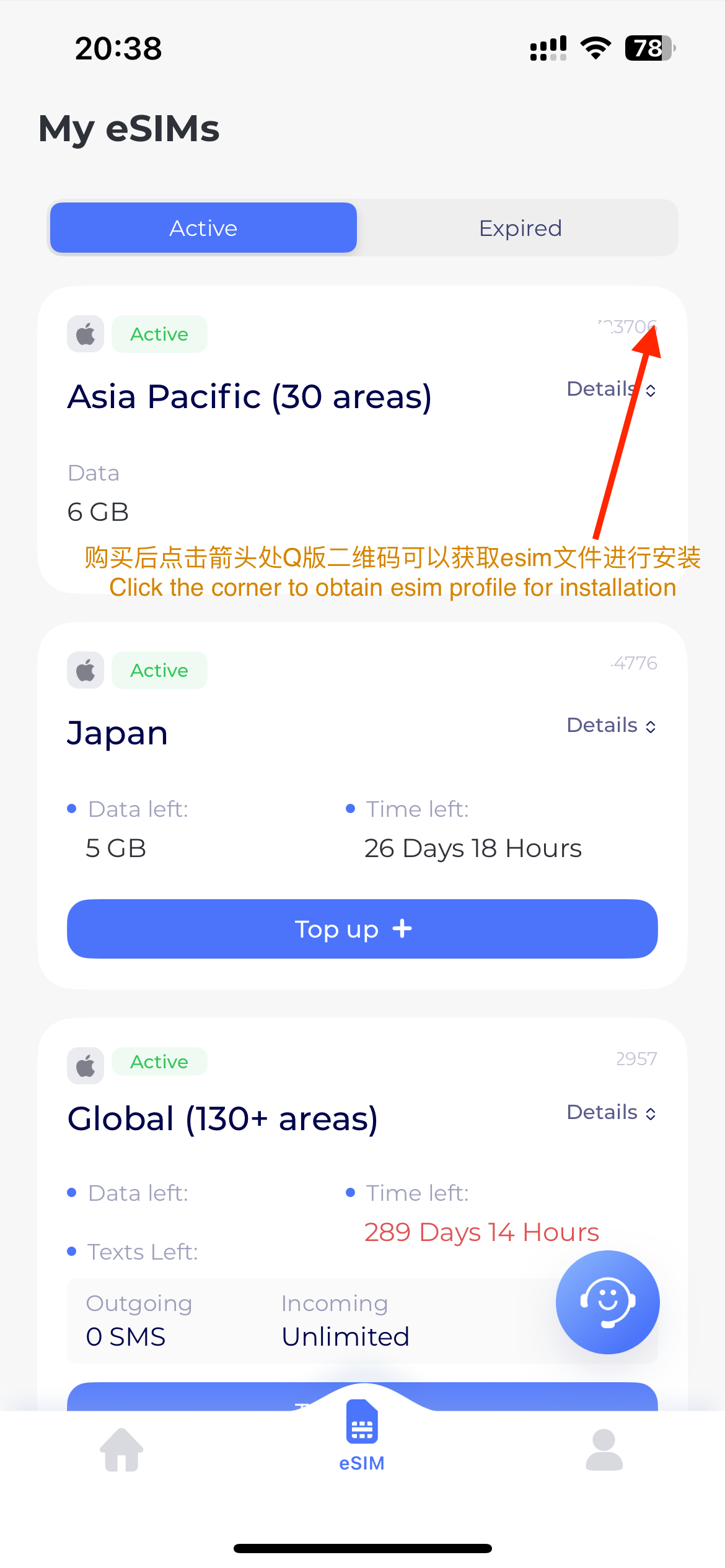

1)购买套餐安装并激活 ( purchase and install esim)

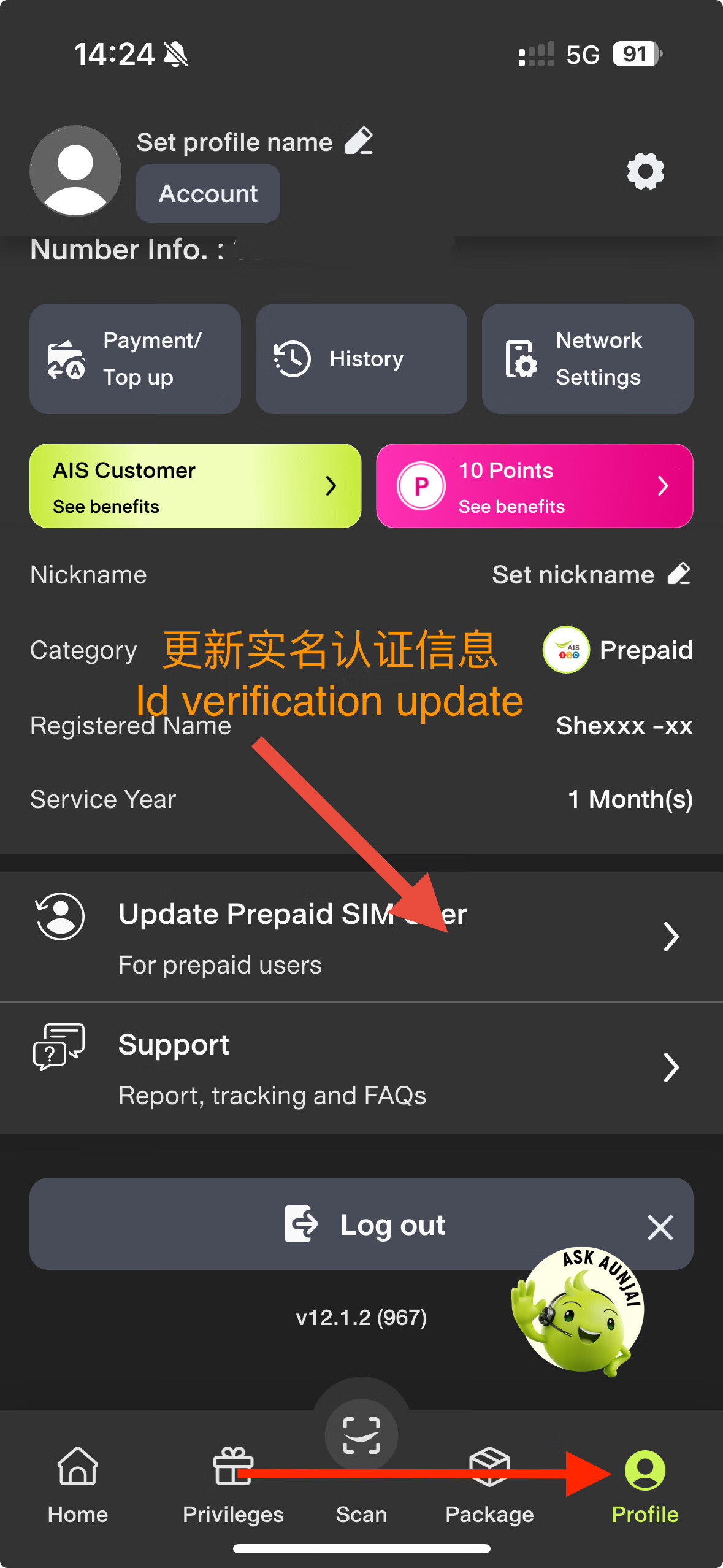

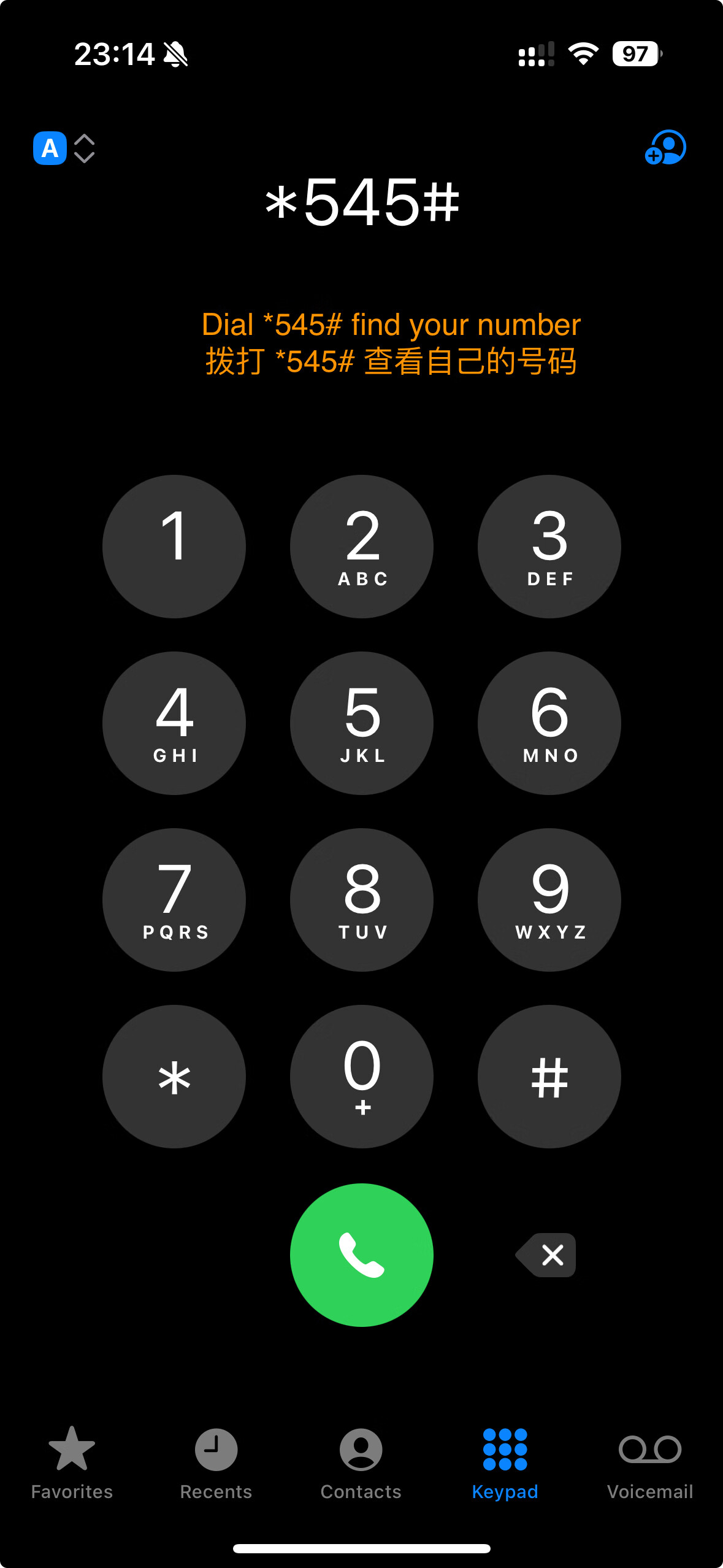

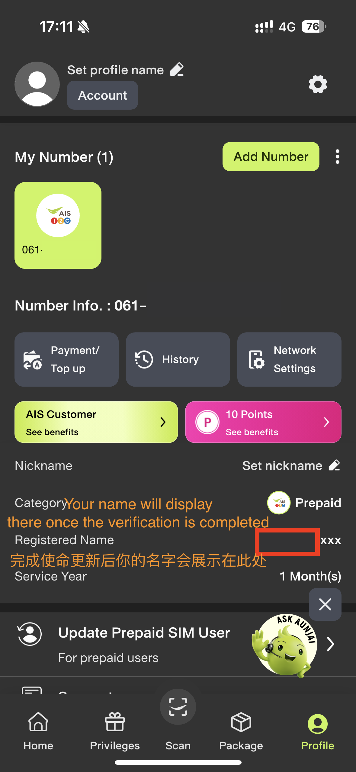

2)查询号码下载 myAIS 登陆 ( Chcek your number for login)

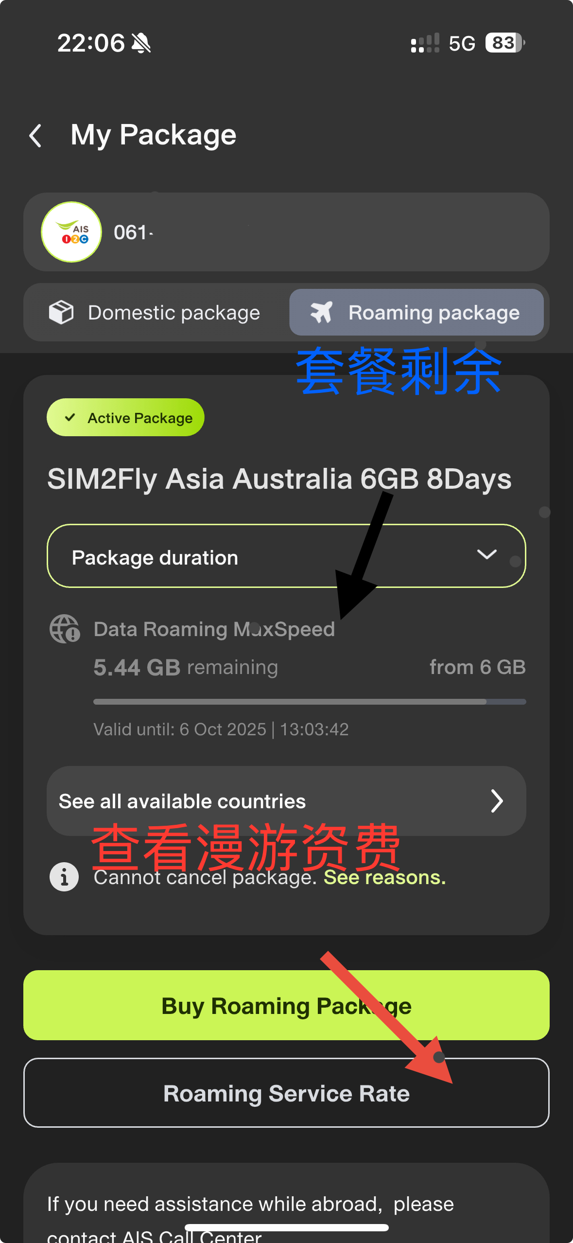

3) 完成KYC认证 ( Finish ID verification

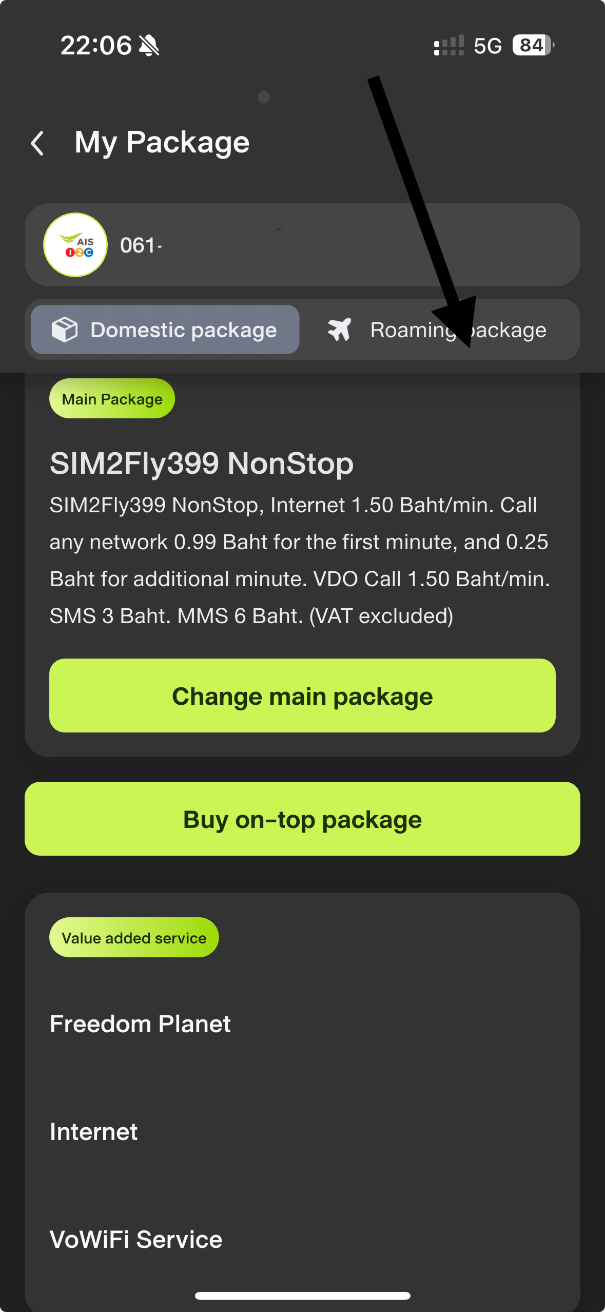

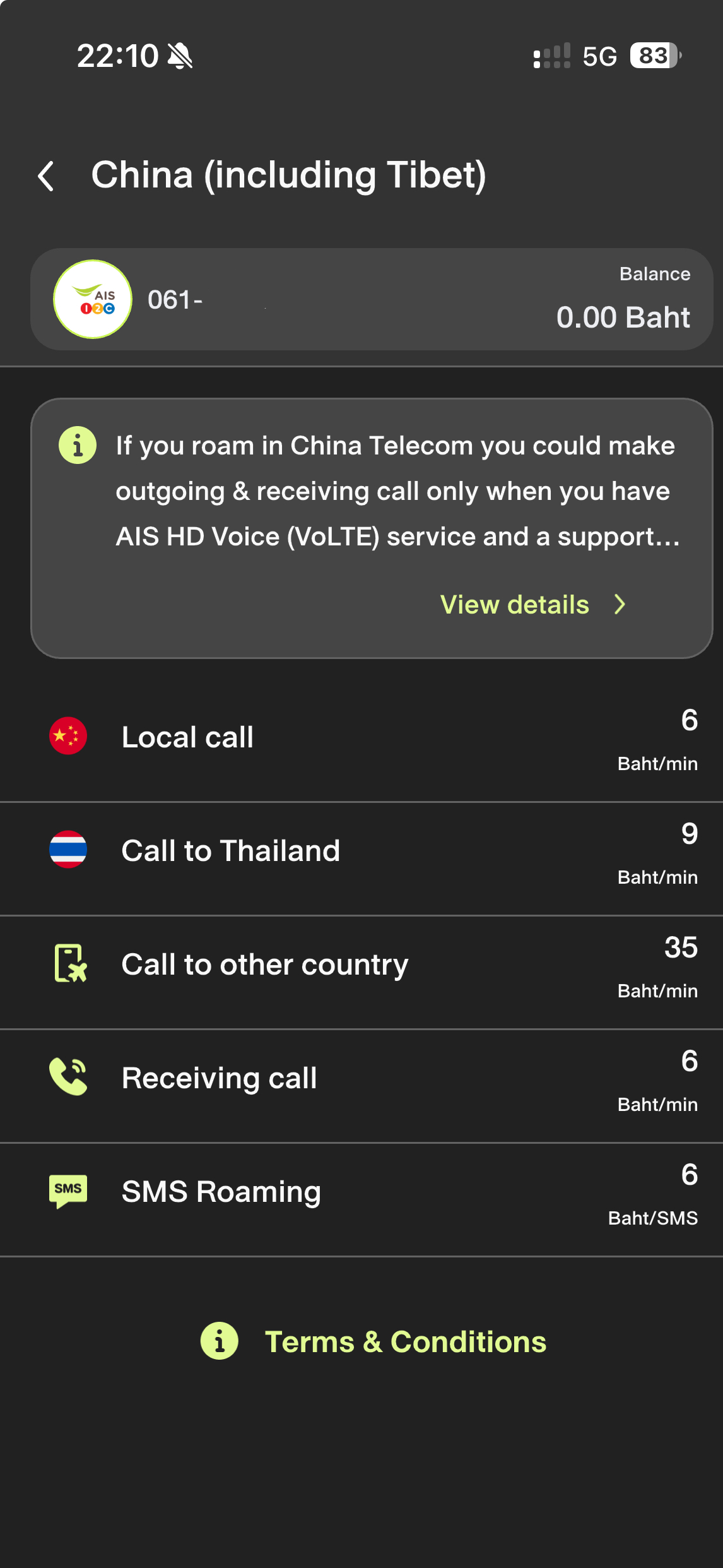

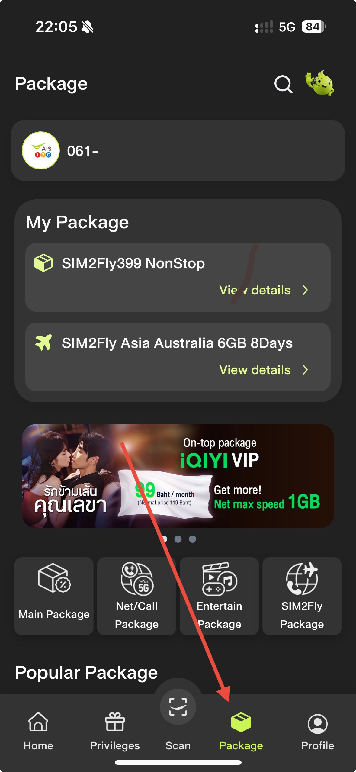

4)在myAIS中查看套餐用量以及漫游资费(Chcek usage and roaming rate):
拨打 *111*6# 也可以查询套餐用量(Check data roaming usage by dialing *111*6#dial

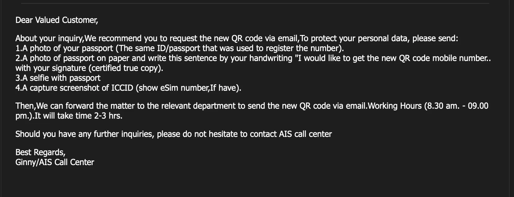

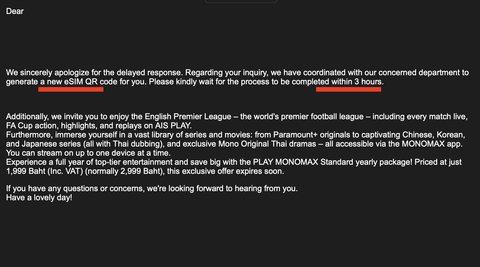

III.请求AIS更换Esim(Replace esim from AIS):

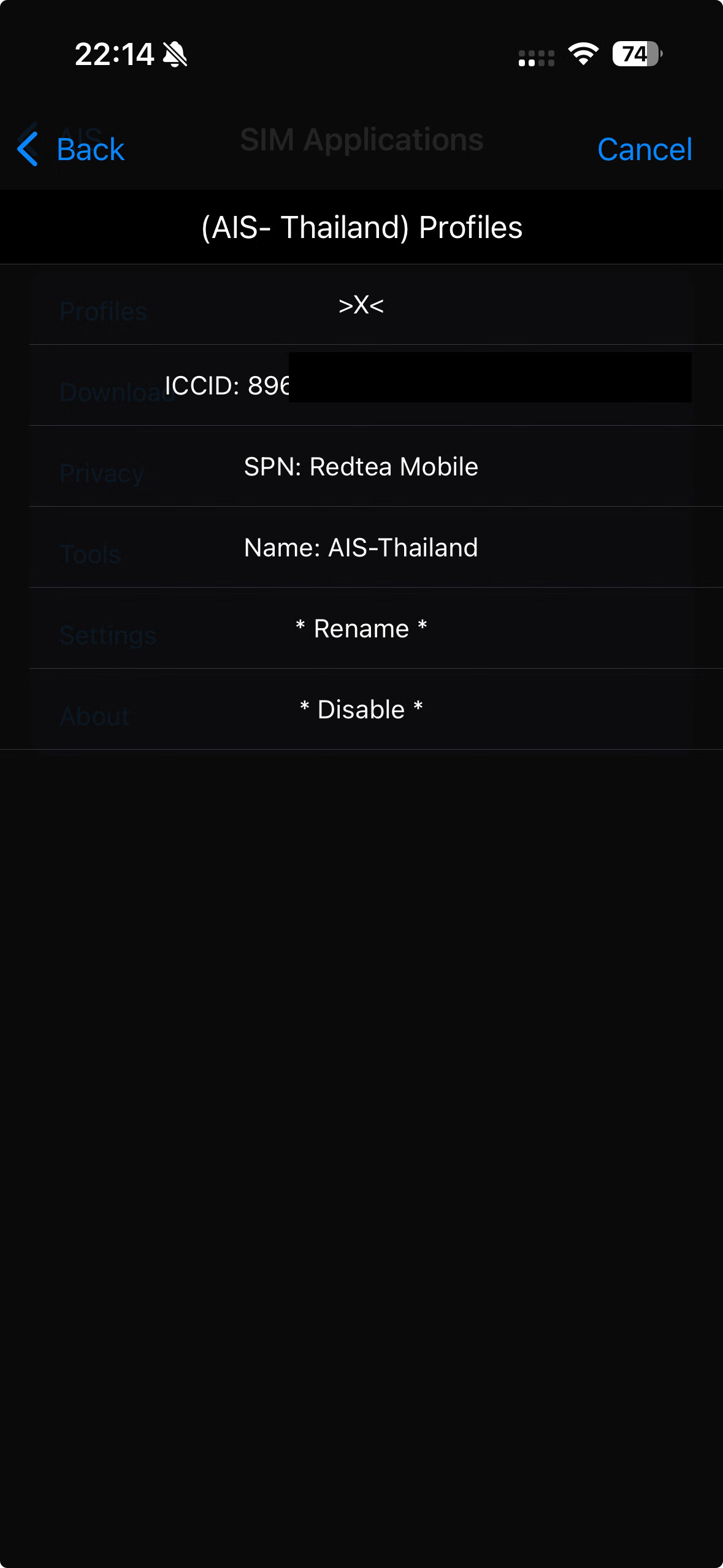

购买的esim是由红茶提供,存在被红茶停用的风险,需要邮件/电话联系AIS获取并下载官方的esim,建议至少在套餐8日流量套餐过期之前完成操作,
The number may be suspended when the data package expires, because it is issued by RedteaGO. It’s better to contact AIS to get a new esim profile before it expires through email or phone call.
1)发送邮件给[callcenter@ais.co.th](mailto:callcenter@ais.co.th) 或者拨打 ’1175’  (AIS 号码免费 )
Email address: [callcenter@ais.co.th](mailto:callcenter@ais.co.th) il or dial ‘1175’ (Free for AIS number)
更换esim的原因因人而异,如果你不知道该怎么描述或许加入我们的群组会给你带来灵感👉🏻:https://shorturl.at/mbvih
The reason why you need to change esim may vary, if you do not know how to write it, join my group may bring you more inspiration.👉🏻:https://shorturl.at/mbvih
2)AIS要求你至少提供KYC的ID照片+更换esim的说明(与ID照片同框)+自拍(与ID照片同框)
a photo or your ID, a phono of description of changing esim with your ID, a selfile with your ID are essential to be sent for the  new QRcode generation.

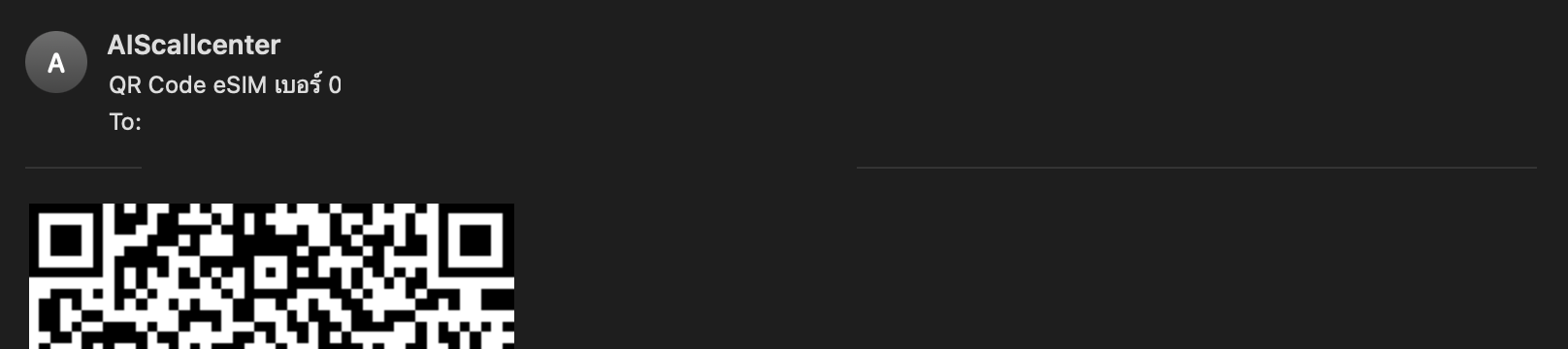

3)2-3小时后获得新的esim(Get your new QRcode in 2-3 hours)

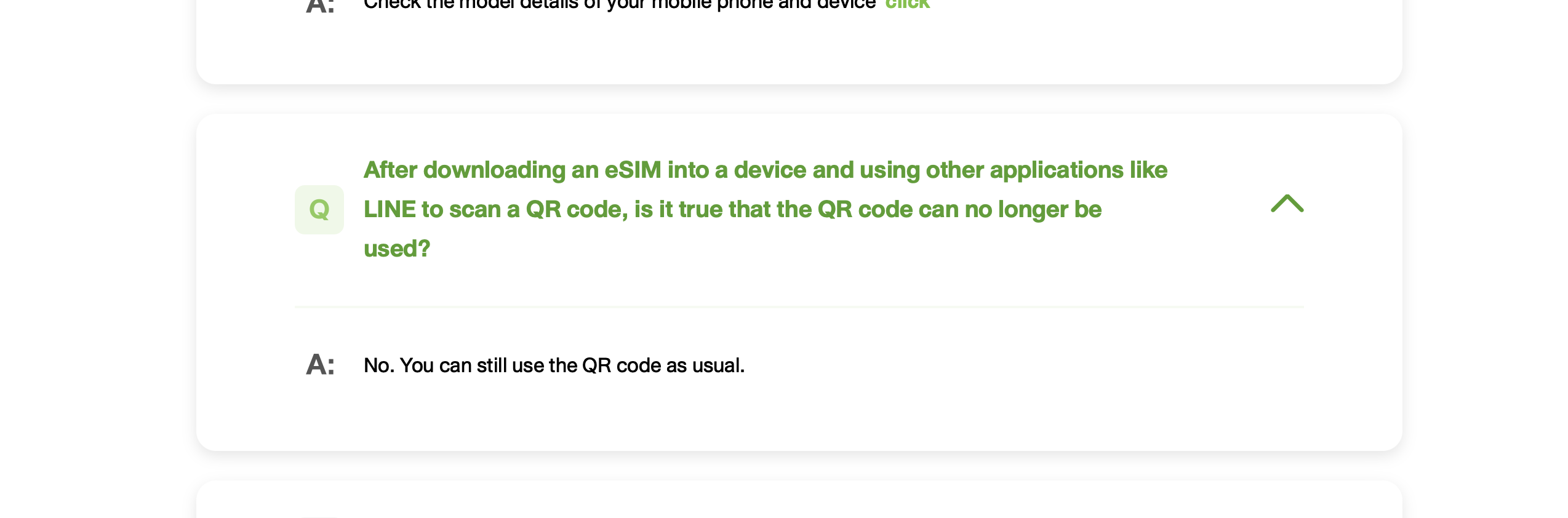

4)esim文件似乎支持多次下载使用(Esim profile may be reused
https://www.ais.th/en/consumers/ ... -plan/esim#esim-faq

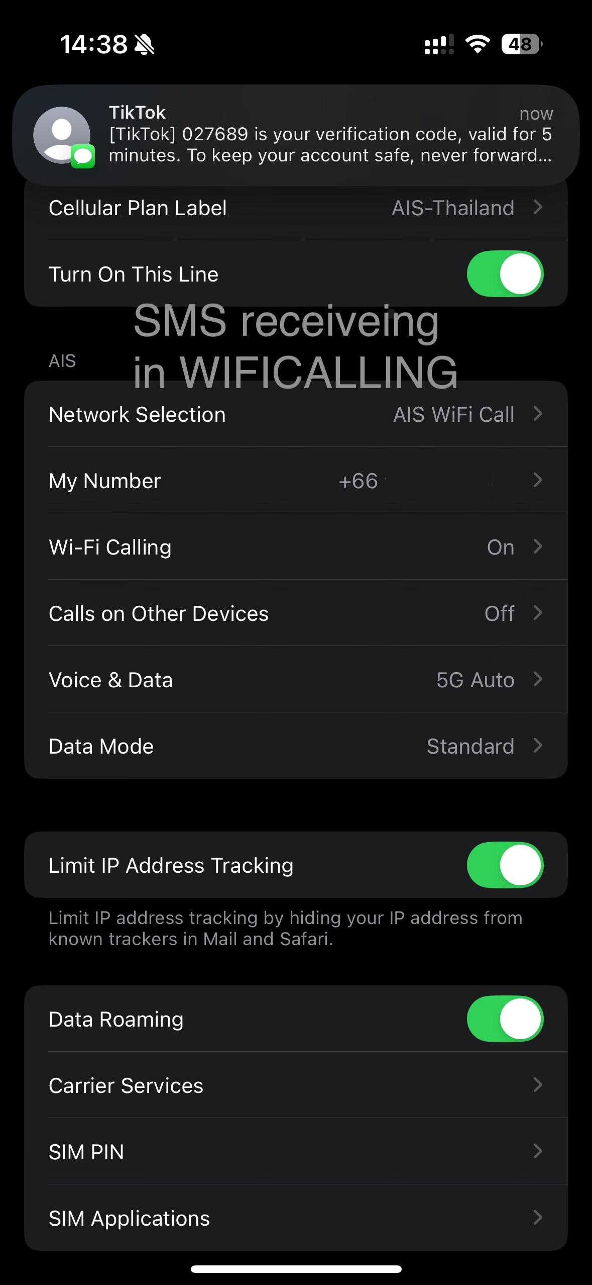

IV.当漫游套餐使用完毕或者过期时,只有2G网络,但wificalling仍然有效(Wificalling and 2G network is available when run out of your roaming data or it expired)
